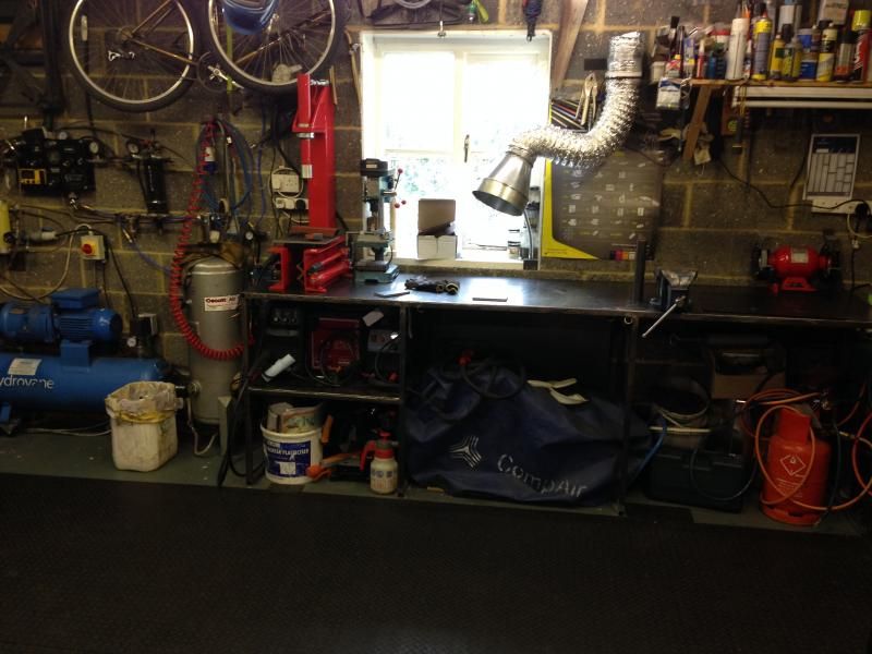

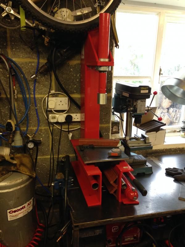

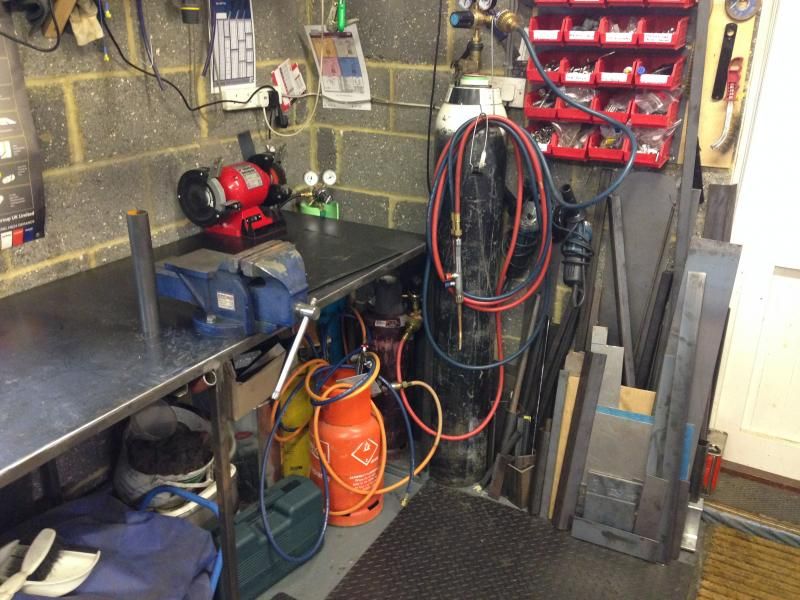

Post by Mr Shiney » Wed Nov 13, 2013 11:20 am
Well my toy finally arrived and is already being put to good use. It makes a doddle of removing the steering stem bolt and bearing from the yoke and using a prototype tool that George has made for me it is even easier to put the bearing back on!!
It bends 5mm over a short length with ease. For making MT bits like a side stand mount and battery box for an MT500 its been great!!
Well worth every penny.
A few pictures of the current workspace set up!
