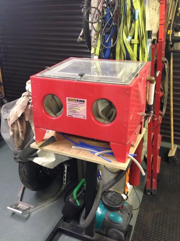

Quite a few club members have seen my set up. Here is my experience....
2.5hp is nowhere near enough to media blast anything other than the tiniest parts with a blast cabinet. 2.5hp is going to give you a FAD of about 3.5cfm. Trying to blast anything with proper filtration will end in disaster. Your compressor will produce huge amounts of water. This will just travel up the hoses and turn the blasting media into paste. Those spot guns are like chocolate fire guards other than for the tiniest job like a rust spot on a frame. I have one that I use for soda blasting engines to clean them up.
I use a Sealey/Power King desktop blast cabinet. This needs 8cfm to run. I use 80grit Aluminium Oxide media. This is connected to my workshop air system which is triple filtered and is capable of removing 99.9999% of moisture. The filter system cost £500 alone. This is all driven by a Hydrovane - Vane compressor giving 10CFM FAD at 10 bar. I also have a double receiver system that auto dumps the moisture traps. Connected to this is a hoover that lowers the pressure in the cabinet to counteract the incoming air flow. If you don't do this then dust just pours out the lid. Make sure you wear a mask as well. Its some nasty shit that comes out in the dust. Neve use sand, it can give you silicoses.
I also have a pressure pot blaster that allows me to blast larger items, but this needs an area that you can recapture the media such as a lined shed or a lot of tarpaulin. It also creates a HUGE amount of mess.
My advice is if you want to do something that does not fit in a workbench blast get cabinet get someone to do it professionally. But whatever you do you must filter the compressor output. Not just for the blast cabinet but for the sake of tools.
The little blast cabinet I have will do most motorbike parts that I need to touch up. Big stuff goes to my local guy who charges naff all.
I use a PCL Dropout system sat behind a standard coalescing and water separating filter. Each workshop port is again filtered and water separated and I have a dedicated Carbon filtered and separated output for spraying and air fed mask.
The one is use is the PDO300A.
http://www.drop-out.co.uk" onclick="window.open(this.href);return false;
http://www.pclairtechnology.com/Product ... m5PMJGfu3s" onclick="window.open(this.href);return false;
http://www.airlines-pneumatics.co.uk/pr ... #technical" onclick="window.open(this.href);return false;
A couple of pictures of my set up.
