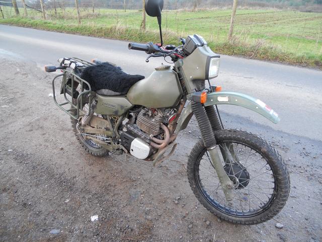

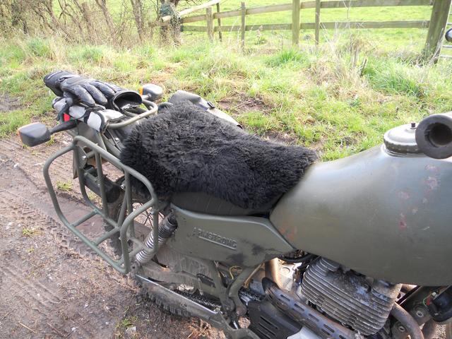

Dunno about you guys but I find the saddle on my MT500 a little slab like, not exactly uncomfortable but a bit like a slab of sprung vinyl which I guess is pretty much what it is. Anyway, looking at a few adventure video's and websites I noticed a few people put sheepskin covers on their saddles, so I thought I'd give it a go, but before I spent money my wife suggested I try a 'seat saver', this is a cover made of quilted wool (kinda sheepskin without the skin) that is designed to fit on a horse riding saddle, she said she had a spare that did not fit either of our saddles so I gave it a try on the MT and it fitted a treat, so with the addition of a length of elastic near the back I installed it and gave it a try by riding up and over the Mendips for a couple of hours this afternoon, it works a treat, no slipping or sliding and a saddle that is just a tiny bit more compliant.

Putting a cover on an old saddle is, to my mind 'Liptick on the Pig'. If you want a softer saddle, especially on a 30 year old bike, renew the foam ( density to your requirement). You can undo the staples easily enough and renew the foam cutting it to size then use a heavy duty stapler to refit. Foam and staples cost buttons. If funds permit a professional could do the job for you.
You could take the opportunity to invest in a new cover also. We have a forum member in the Lake District who makes MT seat covers. You could put your bush fix cover on the top if you wish.
